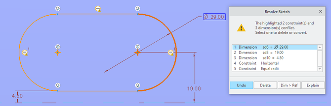

Quite often, sketcher doesn't take into account all the correct dimensions and constraints that effect the conflict when a sketch element (line, arc or point) is over-constrained by too many constraints or dimensions.
I know this, because I can delete a dimension outside of the scope of the conflict list and it resolves the conflict.

I believe the issue being brought up in this post is with Resolve Sketch (Conflict Resolution).
Many times the constraint or dimension that is not wanted is not in the Resolve Sketch list, requiring you to press Undo, delete the unwanted constraint and recreate the wanted constraint or dimension.

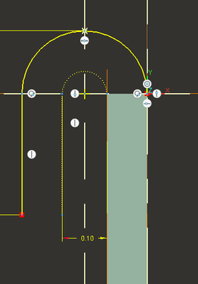

Here's a simple example of how this doesn't work.

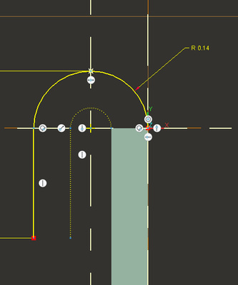

Before with radius R0.14 on the outside of the hem (on the non-construction geometry added by "thicken").
Add .010 dimension for the inside of the hem (on the "thicken" geometry),
and the "Resolve Sketch" does not list the R0.14 dimension which was determining the hem "gap".

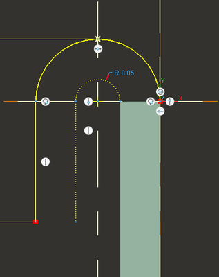

Delete the R.014 dimension and the R0.05 dimension appears.
Add R.10 dimension
Resolved without sketcher conflict.  You have to be creative.
