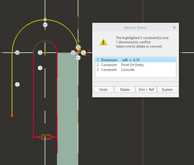

I believe the issue being brought up in this post is with Resolve Sketch (Conflict Resolution).
Many times the constraint or dimension that is not wanted is not in the Resolve Sketch list, requiring you to press Undo, delete the unwanted constraint and recreate the wanted constraint or dimension.
I have also had issues with constraints that I created disappearing, no Resolve Sketch pop-up, when I add another that creates an over constrained condition.
@KenFarley  I agree that the intent managed can be a pain.  I many times use the shift key to disable it on fly.  You can also use LMB to disable an unwanted constraint when it pops up or lock a correct constraint, such as vertical, and holding shift will not disable it.
Here's a simple example of how this doesn't work.
Before with radius R0.14 on the outside of the hem (on the non-construction geometry added by "thicken").
Add .010 dimension for the inside of the hem (on the "thicken" geometry),
and the "Resolve Sketch" does not list the R0.14 dimension which was determining the hem "gap".
Delete the R.014 dimension and the R0.05 dimension appears.
Add R.10 dimension
Resolved without sketcher conflict.  You have to be creative.
