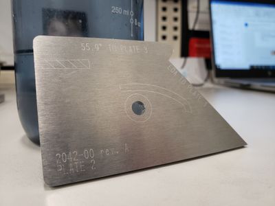

The end product is something like this, this particular component only has "flat" geometry so none of the following was required.

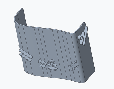

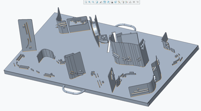

This is the part file I am starting with. The main plate is a sketched line that is extruded upward and outward to create the height and thickness. Then the smaller extrusions are sketched and extruded off of the main plate.

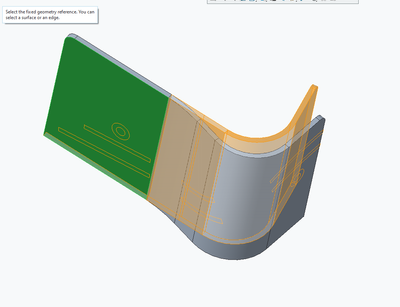

First, I am using the Convert to Sheet Metal tool. I select the flat surface on the right as the driving surface and add purple highlighted sections of the plate to the included surfaces so the whole plate is orange minus the small extrusions (if I add them the model will fail to regenerate).

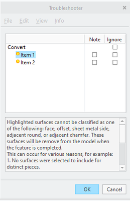

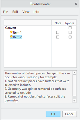

I then select OK and presented with these 2 errors.
And the model begins to look like this with "holes" in it. And one extrusion on it because it would not allow me to remove it from included surfaces.

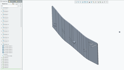

From here I begin to use the unbend tool individually on each curve. The "Flat Pattern" tool only results in a "fail to regenerate". Once un-bent it will look like this, not quite flat and has a part of the model out in space.

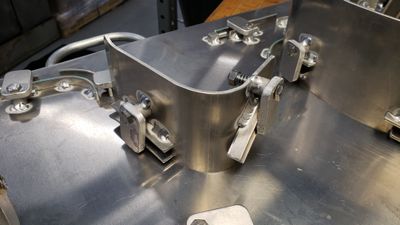

Here is an example of a finished product. Many of these plates are combined into a larger assembly. Is there a way to copy/sketch the face geometry and paste the cosmetic sketch onto a new part that does not have the extrusions? Thanks

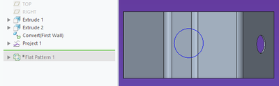

Assuming these are unique assemblies and you do not care about having external references, you can activate the sheetmetal part in the assembly and project a sketch onto the surface using the edges of the part to be welded on.  Attached is a quick example to investigate.

They can be converted from solid.  The thing that you need to avoid is making cuts that leave a piece of solid disconnected from the main body (You could just cut the loose slug out and everything would work with your current method).  My suggestion is to not make cuts to get your scribe lines and project sketches to make the scribe lines.
The holes and extrusions are not just for the scribe lines. They are part of the main part and assembly designing phase. (There are more components not pictured) We could probably just project a cosmetic sketch into the main plate off of the extrusions and suppress the extrusions but when I try to suppress the extrusions it removes the sketch. I'm assuming because it is an outline of the extrusion?  We are also running into an issue of not being able to completely flatten certain plates. Some parts will straighten while one curve will not?
The "slug" left behind from cutting the hole for the tube is not attached to a wall and causes a problem with unbending and the flat pattern feature.  This is also the reason for the errors.
If you are creating the hole to get scribe lines, I would suggest projecting a sketch onto the surface to create the scribe lines.  The projected sketch will "unbend" with the flat pattern.
