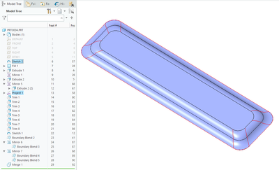

What I tried and it worked fine was to create 2 cross sections and one path section to create a boundary blend in the corners. I mirrored to all corners, joined all with extruded surfaces, thickened to solid and added perimeter lip and cuts. I then was able to do what my original intent was - created a surface from the inside surface, close it, merge and finally solidify.

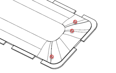

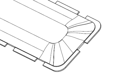

The obvious option is a sweep with multiple trajectories from your description but looking at your pictures would guide me to use rounds in the corners of the geometry shown rather than sweep around them. You can see isoparm lines in your images that are indicative of suboptimal modeling.
These isoparms should probably not exist in t model and should be avoided.

I do agree about the suboptimal modeling. This is one reason I am redoing this.

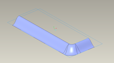

This is a simple approach to make a shape very close to your reference. I think your sweep trajectories may complicate this (in the corners), but the approach is still valid. I have simplified the trajectories relative to your images, but you can mimic this method to get what you need.
If you can deviate from the reference model to correct suboptimal geometry it will be pretty straightforward. If you cannot deviate, then you will need to do something additional in the corners.

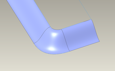

Two sweeps (constant section two trajectories) and a boundary blend for the corner with C1 continuity across boundaries.
This is what the corners should look like when it is built using best practices with C1 continuity on all 4 boundaries of the corner.

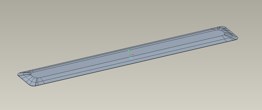

The only reason I am even rebuilding the model is that I wanted to copy the inside surfaces and cap off so I can simulate potting material for thermal analysis use. But those surfaces are not working in the quilt. I am able to merge all my surfaces but am unable to solidify. It is due to the suboptimal geometry I am pretty sure.
Can you post the model you need to use to create the potting volume? If so, someone may be able to extract a useable quilt from that model. What format is the reference model available in?
The file is in Creo 6.0. It was imported. I have attached a zip.
Is the potted volume only filling the negative space of the shell as seen here? This is a solid as if you poured it into the shell when it is level. You may run into meshing issues with this as there are some anomalies in the geometry.

I only have 7.0, so here is a screen shot of my tree and result. No need for sweep.
