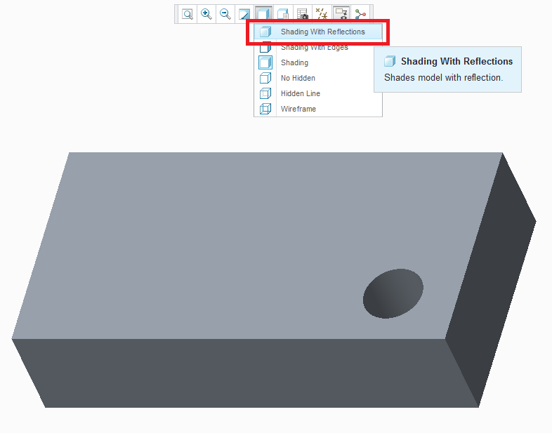

see following pictures showing Creo 3.0 window.
set Shading with reflections mode (you can see texture also in Shading mode)

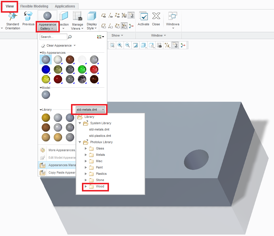

select appropriate dmt-file from texture library
assign appropriate texture to your model

Martin, my bad, found the Photolux Library, and it is really awesome!
But I still have a huge problem -- your birch wood looks so nice and luminous, mine looks so dark and terribly bad (as in fake)...
Is there any way to control the lightness of the skin? For me, all the wood grains come on so dark, there is no way one can distinguish the details of different skins, therefore they all look the same....
