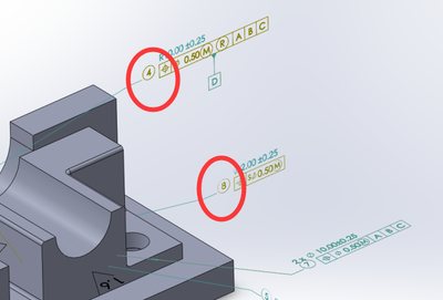

Is there any way to put a serial number in front of the Annotation in Toolkit, like the picture below?
