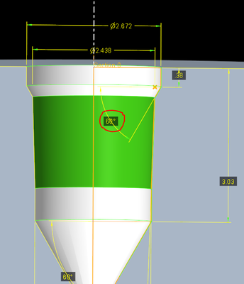

Hi all,
I have a UDF that is a sketched hole. All I am trying to do is edit the sketch to change the angle from 60 degrees to 65 degrees.
How can I modify this sketch? I know I can modify it on the fly, but I want to revise this UDF so when other people use it they don't have to modify the dimension on the fly.
When I go into the UDF Library and choose modify, there is no way for me to modify the original sketch. Also, I can't add the 60 degrees as a dimension on the family table.
