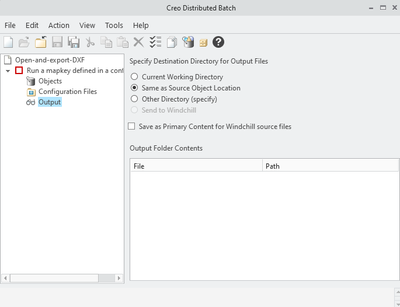

I have been trying to debug this for a while and cannot figure it out. Was hoping someone here could help me.
Creo parametric version: 10.0.4
Creo Distributed batch version: 10.0.4
What I am trying to do:
I have many part files with different names that are 2D curves. I want to export those part files to dxf without opening the files one by one and saving them.
What I have done so far:
I could not get the proper export of the part files to dxf without opening the part as a drawing first. I created a mapkey that opens the current part as a drawing template with the correct view and scale, then saves that drawing as a dxf. The mapkey works when run manually and does save me time.
However, I wanted to speed up the process further by using Creo distributed batch to run that mapkey on all the parts. I have found a way to do this in theory using the mapkey.TTD option in Creo distributed batch. I opened the TTD as text and modified it accordingly so it would run my mapkey (-dxf), then renamed the TTD to mapkey-dxf. I have configured Creo distributed batch to use my config file which contains my mapkey, and selected the mapkey-dxf.TTD as the task group.
My problem:

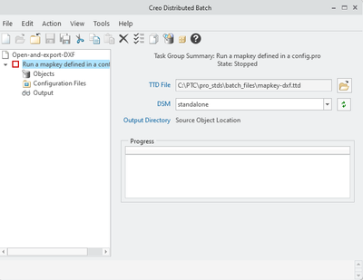

I can add all my parts to the "objects" section in the distributed batch window, and when I start the task they all go from "unsubmitted" to "working", but they never complete or fail. It simply stays "working" forever.
I have very limited experience with Creo distributed batch, so I might be doing something wrong / have a setting wrong. Maybe my mapkey needs to be modified since it works when the part is already open, but the batch process is different. I hope someone can point me in the right direction.
Here are some images for additional information. I have also attached text files with the code for my mapkey and dxc file. I added the code for the TTD file because I could not figure out how to attach it here (even when changed to txt it wouldn't let me post?)
TTD file code:
<?xml version="1.0" encoding="UTF-8"?>
<!-- 05-Oct-09 L-05-10 CHI  $$1  Submitted -->
<!-- 07-Jan-10 L-05-14 CHI  $$2  Remove out-of-date comment -->
<!-- 17-Feb-15 P-30-03 mtch $$3  Added group -->
<!-- 15-Jun-15 P-30-11 mtch $$4  Added save_model -->
<!-- 13-Oct-15 P-30-18 mtch $$5  Added drw to FILTER_FILE_TYPES -->
<TTD version="1.0" created_by="PTC">
        <DESCRIPTION>Run a mapkey defined in a config.pro</DESCRIPTION>
        <GROUP>Misc</GROUP>
        <DETAILS>Will be run on any file type; user is responsible for choosing types that mapkey will operate on correctly.</DETAILS>
        <SERVICE name="dbatchs"/>
<FILTER_FILE_TYPES type=".prt .asm .drw .sldprt .sldasm .catpart .catproduct .cgr"/>
<!-- Replace "F1" with chosen mapkey when customizing file -->
        <TKFUNC func="ProMapkeyRun" mapkey_key_sequence="-dxf">
          <save_model>false</save_model>
        </TKFUNC>
</TTD>

My guess is something in your mapkey macro is trying to display something, but since you're running batch it can't?
Also, you can probably trim the macro a bit, maybe delete all the Input 'dwg_create'... lines and just have the Update 'dwg_create'... line That's typically what I have in my macros, they just have a Select line and then an Update line.
Here's a similar inquiry from the past:
https://community.ptc.com/t5/System-Administration/Distributed-Batch-in-graphics-mode/td-p/546645
Thank you for the reply.
You are right about my mapkey, I have removed the extra lines like you said, and it still works perfectly.
As for the display from the mapkey, my operation does open dialogue boxes, but the mapkey itself does not require user input once it is started.
Would the batch file still be interrupted if the mapkey is able to run without user input? I do not know how I could open my file as a drawing and save it without opening the "new drawing file" box and the "save as" box.
