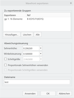

- the wavefront export settings I dont change:
- the wavefront export window opens. I choose the coordinate system of the assembly to define the export. Sometimes (not this time) the String height, Angle control and / or Step size I change but this should't change the colours.
- I press "apply" and "ok"
