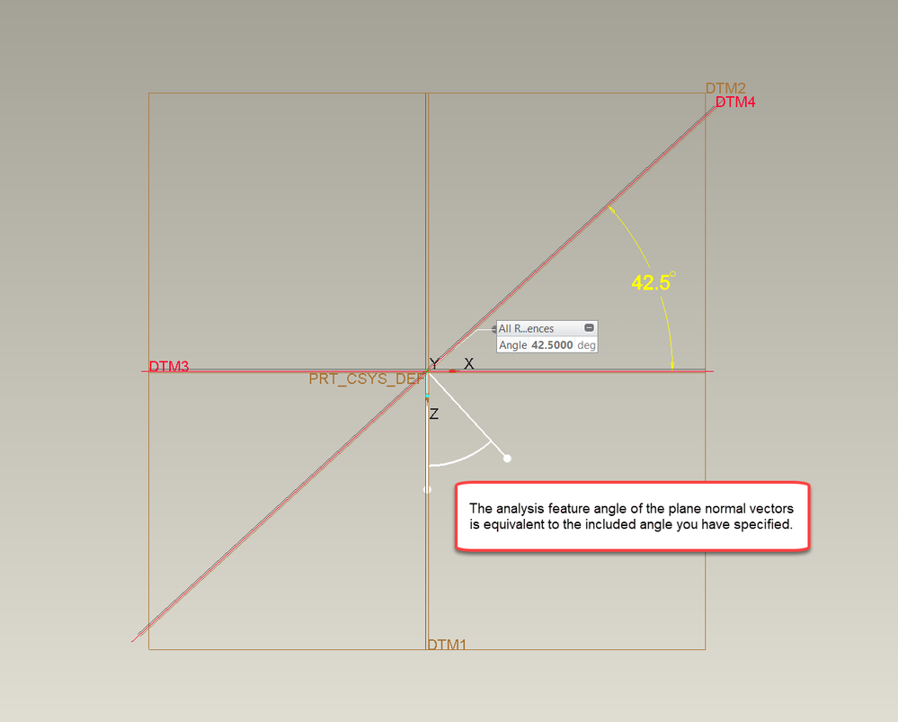

I am using the analysis feature in Creo 6 to measure angles. I have read that Creo applies the angles to the normals which makes no sense to me. Even if I select supplement, conjugate, etc., Creo never shows the angle the way it needs to be in order to be clear. Please see attached screenshot. The angle that I measured is shown with the red arrows, but Creo shows only the angle to the normals. This is confusing, especially when you show this to someone that does not use Creo.
Is there any settings that would get the angle measurement to show as expected?

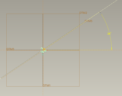

Two options come to mind for a workaround.
You can create a construction feature that explicitly dimensions the angle as you desire and use that to control the angle offset of the plane.
If you were to create a dimension instead of an analysis would that still work for your intended purpose? Here is an example of an annotation dim.

If you want to use the analysis feature to yield the angle of interest what prevents you from creating a relation that will calculate the value of the included angle by using the analysis measure as an input?

The angle you seek is implicit in the Analysis feature when measuring between two planes. It may not display the included angle that you want but there is an equivalent angle available in the analysis feature. Unless I am missing something, you can use the analysis feature to provide the angle value of interest directly.
I don't understand why the analysis feature can't show the angle that is most logical without having to rely on an equivalent angle.
Hmm, if you need to illustrate the angle measurement, then probably making an annotation state with the dimension would be most clear and useful as it becomes a persistent documentation. If you just need to quickly check the angle, then it seems to make little difference how it is displayed. As was pointed out, the angle between normals is the included angle you seek. I suppose it doesn't make intuitive sense to us humans, but that's how the math works behind the scenes. Anyway, please submit a product idea about it.
