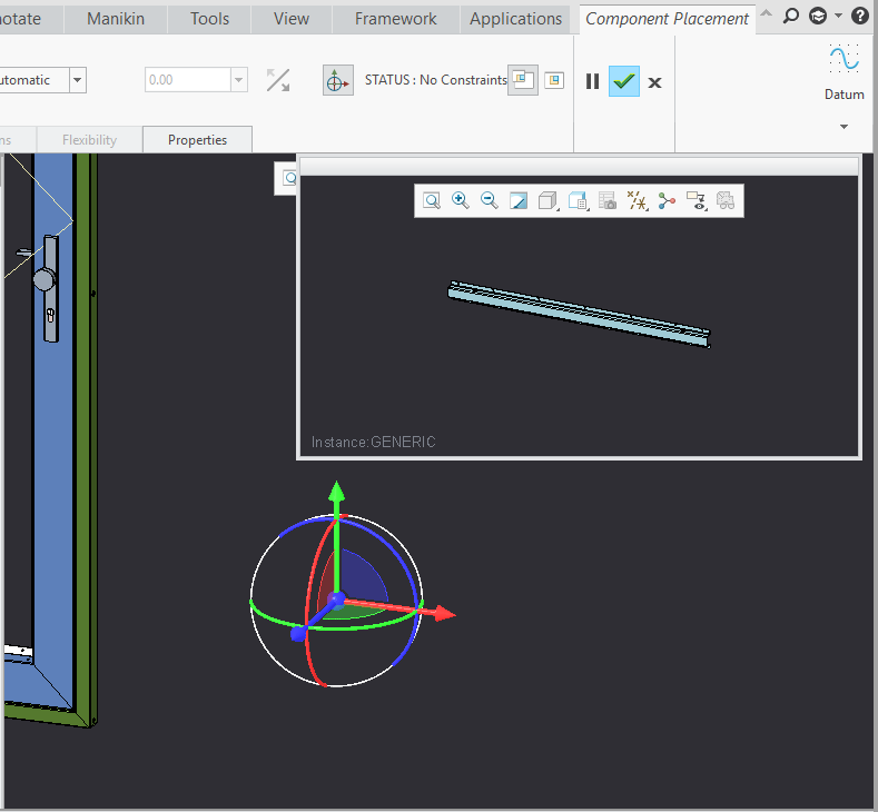

We have been tweaking our config.pro lately, adjusting settings which we normaly set by hand.
So one setting is the comp_assemble_start, which we have set at contrain_in_window. When adding a new component to an assembly, this setting will show a new window for that component.

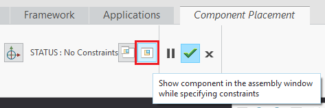

But the component is not being shown in the main 3D window. We have to click the button "Show component in the assembly window while specifying constraints"
So searching for more config options, I encounter display_comps_to_assemble, which we have set to yes, but nothing happens. It seems like Creo is ignoring that setting.

You want both options to be activated, showing the component in a separate window and showing it in the assembly window?
my comp_assemble_start is set to default, and if you read the description for display_comps_to_assemble it doesn't seem to have anything to do with this setting. What happens if you just set comp_assemble_start to default?
Yes, I would like to have both.
Here's what we now have:
As you can see, the component being placed has it's own window, but it is not being shown in the window of the assembly.
This is what we want:
You can now see the component being placed in the assembly window too (in purple). I believe that display_comps_to_assemble controls that button, but it looks like Creo ignores it.
If I set comp_assemble_start to default, then the new component will not have it's own window, but the component is shown in purple in the assembly window.
The button "Show component in the assembly window while specifying constraints" is pressed automaticly (enabled), and can not be "unpressed" (disabled) (which makes sense, because otherwise you would not see anything at all).
