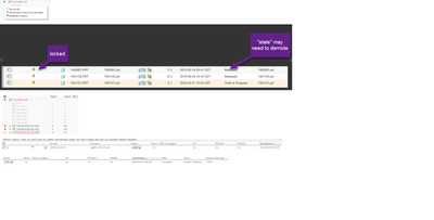

I am just trying to use the assembly for FEM exporting STEP.  How can i create a coordinate system by importing one from a step file or other format at the TOP level.  How can I do this while another designer has the assembly checked out / my workspace is out of date.  I do not care about updates.

There are potentially several things happening. And your companies windchill setup will likely vary from mine.
The image you sent is a toggle, if it has a check, it is locked. Yours is unchecked, therefore it is unlocked.
It might help if you include a screen shot of what your workspace looks like for that specific line.
Here are a couple of things you can see in the workspace
The "State" value may be custom for your workplace, we mostly used released (unmodifiable) and work in progress (modifable)
You change the state by clicking the check box on the line of the item and then going to edit set state...your workplace may have processes in place to control this.

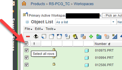

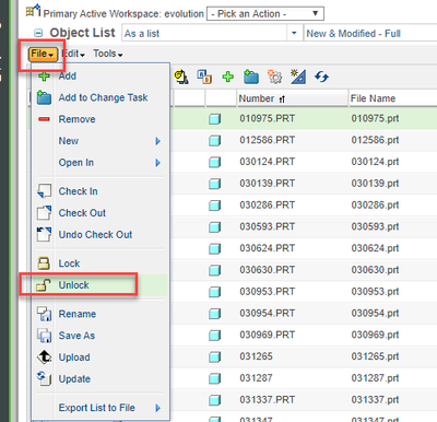

Let's try the select all in your workspace, then File - Unlock.
I do not have a file unlock.  Any other suggestions?
StephenW
(To:Cody_Godines)
@Cody_Godines
i see it in the creo subwindow now.   it wasnt available in chrome browser which i use because it is bigger.  thank you Stephen
