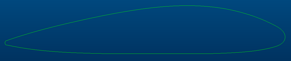

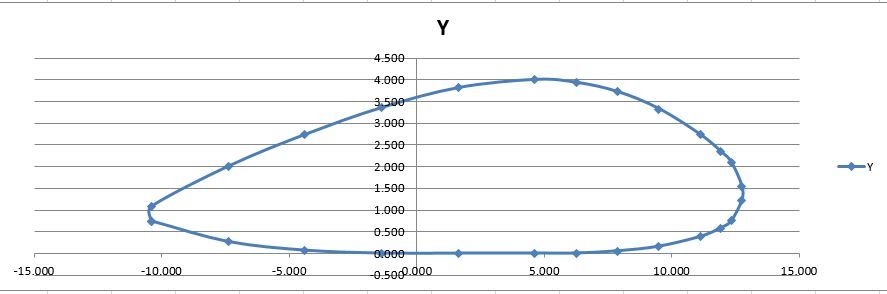

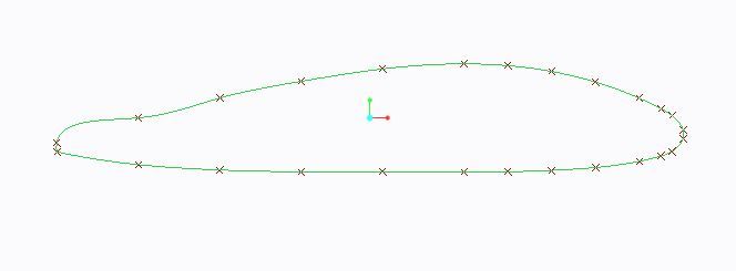

Can anyone please help me how to edit the curve which is drawn through points.
I have plotted the curve in Microsoft excel and creo but the curve from creo is different. can anyone please help me to solve my issue. I need a curve which is similar to the one drawn using excel(image-1).
I have attached the profile points excel sheet.

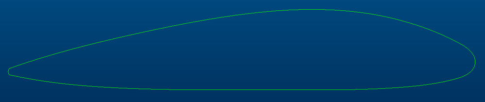

curve.pngHi,
  • remove line no.28 from Excel table (it is equal to line no.2)
  • create points offset from csys
  • create 1-st curve through points using points offset from csys
  • create 2-nd curve through points ... connect start and end point of 1-st curve + define tangency in end points
You will get this shape:

 Hi naveen,
Your excel curve has not the same scale on X & Y, that is why the curve shown in Creo is different (but much true).

Hi Martin,
Thanks a lot for helping me solve my problemSmiley Very Happy
