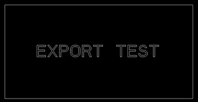

I do not know if 3d DXF creo export supports sketch/curve data. In the export option, it only shows facets and quilts. I don't use 3d DXF so I am not very helpful. Sorry.
If you make a drawing for the skeleton, you will be able to export it with lines and curves. It doesn't seem possible to export lines from the 3D model.

I have AAX and I can't export the way you're asking. The example I sent previously was an actual skeleton model, not a regular part. You may need to export your part to a format that you can open in another tool to export a 3D DXF from. AutoCAD seemed to work fine for me. I was able to import a step and export a 3D DXF.
