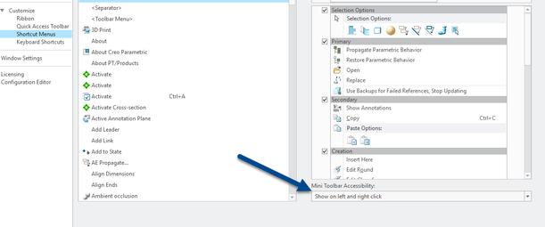

Can you check on this setting? You may have to set it to the proper value and export a new customization.ui.
You could also reset your customizations if that doesn't work.

Thats it, thank you!
