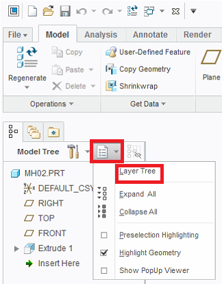

activate Layer Tree
pic01.pngclick right mouse button to get context menu

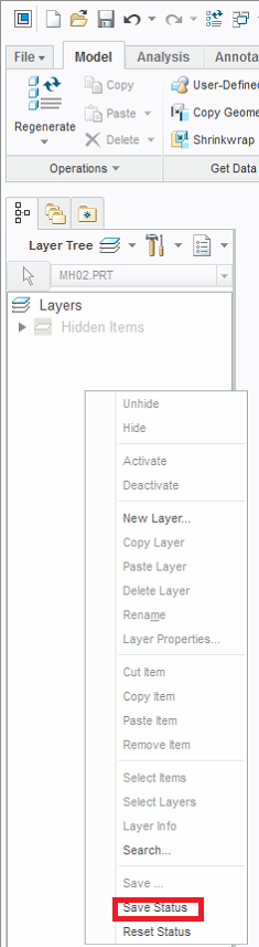

save layer status before saving a model.

can you please, guide how to save settings ,
where can i find that option

MartinHanak
(To:vdevan)
activate Layer Tree
