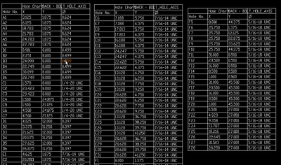

how can i divide a hole table?? there is the possibility to paginate it as i can do with repeat regions??
i know, but the table i already have with a single segment, does not change if i modify rows number.
if i delete it, and create a 30 rows holes tabe, then i can change the rows number.
just this litte bug happen, but the solution is perfect

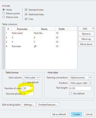

You can set the number of rows and then drag/move each section onto the page you want.

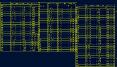

These are broken up, but on the same page.
Dale

i've tried but on an already create hole table.
it seems to work only for the table you are creating.

I hadn't seen this before, but it worked.
Then select the table (the one peeking beneath the pop-up)
Changed is to 20, updated. Now I have (4) table with a maximum 20 rows each that I can move around.
