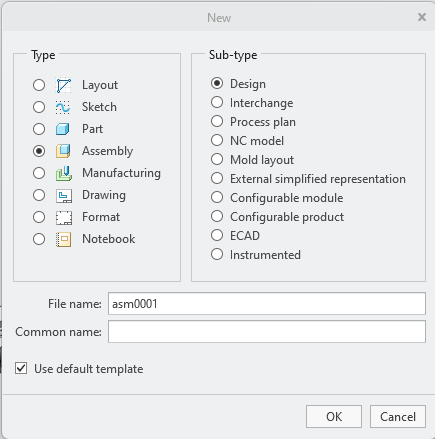

i would like to understand the template names when starting a new document
PG_11980159
3-Newcomer
i would like to understand the template names when starting a new document. is there a reference to all the template names (eg mmks_asm.design_abs and all the other variants)
They are abbreviated
in = inches
mm = millimeters
k = kilogram
abs = absolute accuracy
rel = relative accuracy
n = newtons
s = seconds
and so on.

template names.jpgok, i was more so looking for these explanations, mmks, mmns, list goes on
in = inches
mm = millimeters
k = kilogram
n = newtons
s = seconds
and so on.
thanks Michael, it seems so obvious now that you have said it, 😀. cheers for the info
