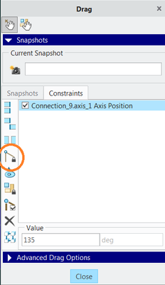

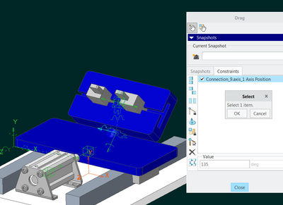

Seems you have your answer, but no one mentioned that when using the "Drag components" tool, there is the constraints tab in which you have all kinds of ways to stage your mechanism and lock its joints to a specific value:
this is more in line with what i am after. However does this lock the movement or does it simply orient the movement. I.E does drag components the override the constraints
pausob
(To:CreoCarlos)
In the example I show, the angle of the joint is locked to 135 degrees.  The constraint I used is the "lock joint axis" :
During dragging, these overrides are active - so the joint will always stay at 135.  However, AFAIK, these overrides are active only while this Drag Components tool is open, and I'm not sure if they can be saved for reuse.
