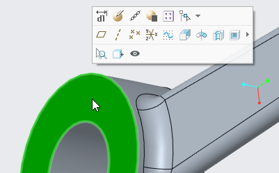

Currently I am using CREO 3.0 M140. When I select an item in the graphics window, NO mini toolbar will show up by any means. I did a lot of search but seemed no one had the same issue. if you check the screenshot of  my "CREO options" attached behind, there is only "shortcut menu", no "mini toolbar". (btw, even for the "shortcut menu", I couldn't customize anything. I cannot drag and drop icons there).
Anyone has idea to help me find the mini toolbar? Thanks a lot!

Could you elaborate a bit what you mean by "mini toolbar"? If that's what you're talking about:
Then no wonder it doesn't show in Creo 3.0, because it was introduced in Creo 4.0. In Creo 3.0 and older you only have right-click menu (or Shortcut menu).

Yes what I was asking is exactly the small selection-based user interface. I feel ashamed to have raised this question ... I guess I had either muddled up CREO 4.0 with all the previous verisons, or another software with CREO... Thank you for the clarification!
