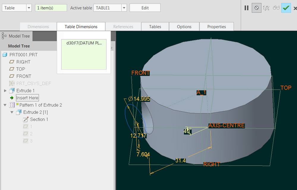

If you create the first feature based on a radial dimension about the axis, you can use pattern by table to enter any values that you want for the angle dimension.
erv
(To:kdirth)

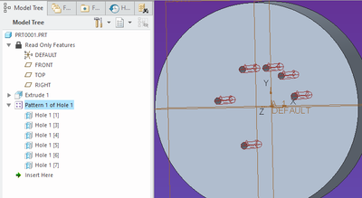

thank you for the tip.  It certainly works for a feature that can be dimensioned from the axis (where the sketching plain of the feature is perpendicular to the to the axis).  I was not aware of the technique.  But the case I'm working with the feature's sketching plain parallels the pattern's axis so I am unable to create the angle demission (at least I have not figured out a way).
See screen shot below:
In the below screenshot, is the axis of the extrude feature I am attempting to pattern.

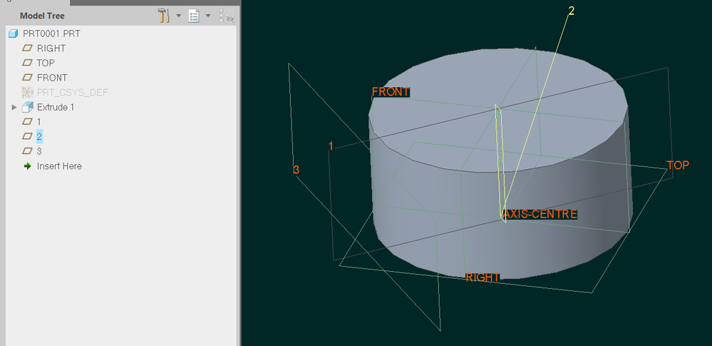

Excuse me for assuming, but I think you are starting to use Creo you don't know that you can construct datum features by "chaining" multiple datum features?  Also, these datums can be absorbed into the feature by simply dragging them into the feature in the model tree.
This is related to the concept of "datum on the fly" - where one builds these internal datums during the feature creation.

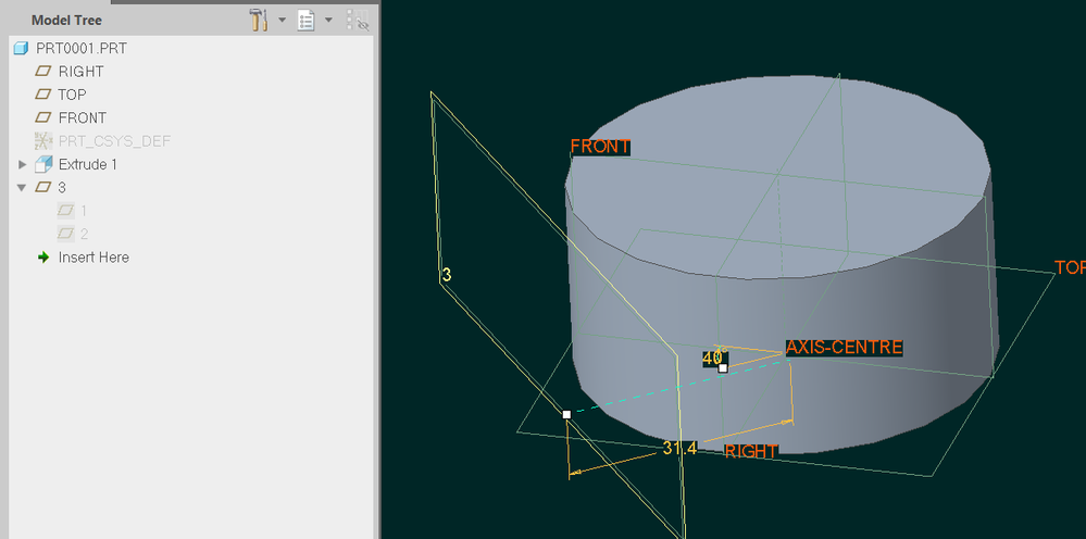

For example:
Datum "3" parallel to Central axisDatum "3" parallel to Central axis
Datum "3" is offset from datum "2"
Datum "2" is perpendicular to datum "1" and through "Axis-Centre"
Datum "1" is through "Axis-Centre" and at an angle to FRONT plane
Note that "1" and "2" can then be absorbed into datum "3" (select "1" and "2" in the model tree and drag onto "3"):
In your case, you can absorb all the datums into the feature you are patterning and then their controlling dimensions (e.g. the clocking angle) become available for defining the placement of instances:
