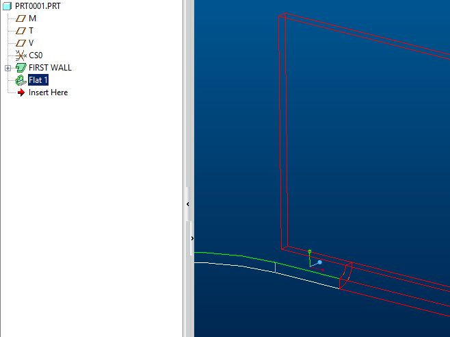

hi,
i have to reduce the length of the bend, how ever the flange length shall remain the same...
in the attached image i have done by doing an extrude cut ..
is there an option in creo to do this ...
Thanks in advance...
You can create a "User Defined" flange, and sketch the reduced bend. No need for extra features.

You may also do the flange width equal to the bens, then add a secondary flange to the first to get back the width. This method may cause less issues with unbending.

Thanks a lot my friend...
