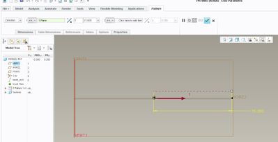

Create a new part.
create a sketch feature with one complete sinusoid.
finish that sketch feature
Select the sketch feature in the model tree.
select Pattern
change the option to direction
select a datum plane that make the pattern go in the direction you want it to
enter the increment  that works for you sinusoid.
enter the number of repeats.

Pattern is what you want, I believe.  You may be familiar with Solidworks which allos for patterns within a single sketch. You cannot pattern within a single sketch in Creo.
So, create the sketch of the initial sketch with the two semicircumferences then pattern that sketch 230 times.  You probably want a directional pattern with the increment set the same as the length of your intial sketch. Select you sketch feature, select pattern on the toolbar, set to direction, pick an appropriate direction reference, enter an increment, set it to 230 instances.
