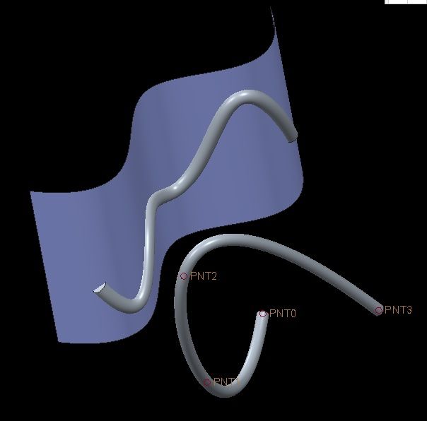

I want to use "insert sweep protrusion" using a "3D" curve as the trajectory.
I have in the past always done this with intersected curves, but sometimes that's a lot of work.
I thought this would be easier if I just defined a set of points and put in a curve using them.
I defined a set of points using Offset Coordinate System Datum Point Tool.
Then I put in a curve using "through points".
When the points are all co-planar (on the YZ plane in my pictures), the Insert Sweep Protursion command accepts the curve
and the protrusion comes in fine.
Once I make the points and curve not co-planar, ProE will not accept the curve as the trajectory and gives the message
"Specified trajectory is not valid. Please reselect."
This really sucks.
Is there any way to get ProE to accept the 3D curve without having to do intersected curves?

Dunno what you're doing, but I got a swept solid using both a curve projected onto a surface and a curve thru points.  Then again, I'm on creo 3, and I remember getting the "invalid trajectory" for the old sweeps.  When they bundled it into one command (Yay, smart move - unlike the ribbon...), it seems to be as robust in taking trajectories as the old Variable Section Sweep was.  so, I'm guessing you're on an old version of Pro/E, and as such bfrandsen's reply should work.  In the future, you should post what version you're using.AA-SWEEP1.jpg

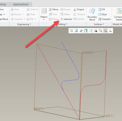

Currently in Creo, you can generate your 2d curves and then use the intersect command under the model tab  (editing area of the model tab
yes, but with the REAL geometry I entered, it would not intersect the curves.  The particular case had a 171 degree bend between the two different 2D curves.   would not intersect
