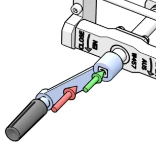

I would like to animate a crank rotation. For this I use the effect Screw Turning.
Unfortunately, the crank turns around a wrong (default?-) axis (red arrow). I would like it to turn around the axis of the green arrow.
I have already tried to select other coordinate systems, but it doesn't change. Does anyone have any advice?
Thanks and greetings
Ramon

I think the coordinate system area of the Driver Effects Properties menu is a role that specifies only the direction of rotation, not the center of rotation, in a single part.
I think we need to improve at the program level

Hello, let me introduce how I write about this problem.
First, combine the green arrow and the rotary handle to coordinate by the arrow, then record the animation and delete the arrow animation.
I don't know if this is the best way, but it's easy to use.
Thank you.
Although this workaround should work, you shouldn't need to add a symbol in just to achieve the desired result.
I would suggest this is a good candidate for an enhancement idea on the forum.

Hi Ramon,
I think the issue is that the unscrew effect is always using the center point of the selected part(s) as the rotation point.
The csys is only used for direction, I think this is where an enhancement is required.
An option to use the csys as the rotation point might be one solution.

Hi SP_
you made my day!
Your solution works well, thank's a lot 👍
