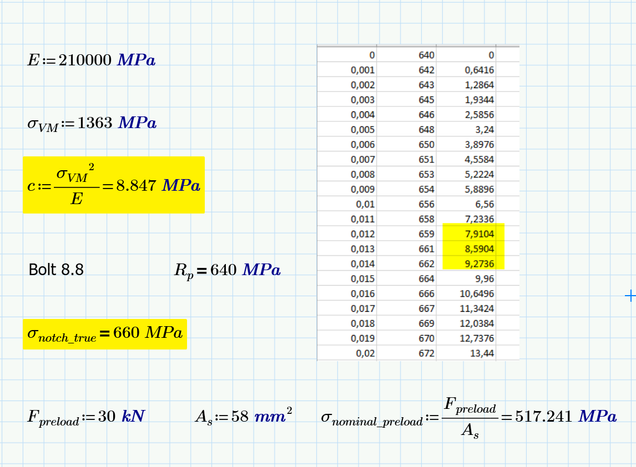

Neuber notch stress (true)

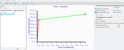

elastic plastic material is required but not necessary for this model
skunks
(To:PS_10114112)
att. ideal elastic-plastic
Thank you.
I could run the simulation.

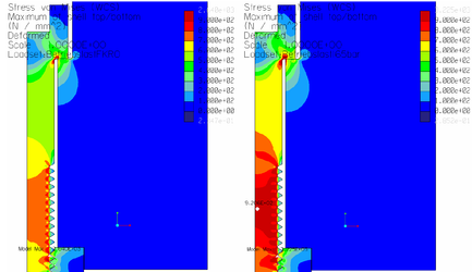

1. How the contact between external thread region of bolt and internal thread region of block considered? In this model(creo simulate) I could not find any interface defined for that region.
2. I could see the interface between washer  and block suppressed for simulating the elasto-plastic situation. Will this give the exact result, as the real situation is with a contact at this region.

I prefer my first model,
but for exact results the model needs to be much finer...
Equivalent Plastic strain is a required output. In second method I am able to get the Equivalent Plastic strain. since some contacts are not defined in second method, the result is doubtful.
Can we have any other method in creo simulate to do get the Equivalent Plastic strain of elasto-plastic material?

You want a fine model with the thread in detail?
I could build one.
I need Equivalent Plastic strain of the bolt in the model I shared initially. with or without thread doesn't matters. The stress and Equivalent Plastic strain obtained in 2nd method are not matching to the result from ABACUS.

I build a fine model.
For comparison you need the same material law.
skunks
(To:skunks)
with thread att.
please check preload and material law
Unclear exactly what you are trying to achieve with this analysis, but typically fasteners are not analyzed with a FEM. There are closed form hand calcs for the various things that you need to get out of a preloaded joint. If you are not familiar with these methods, I would suggest reviewing NASA 5020.
I am working with a threaded joint, to find its static FOS of threaded component, with stress at the thread is more than the yield point of material. for this purpose the Equivalent Plastic strain is required.

Were you able to achieve a result?
enclosed is my comparison
