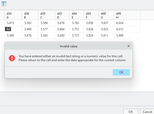

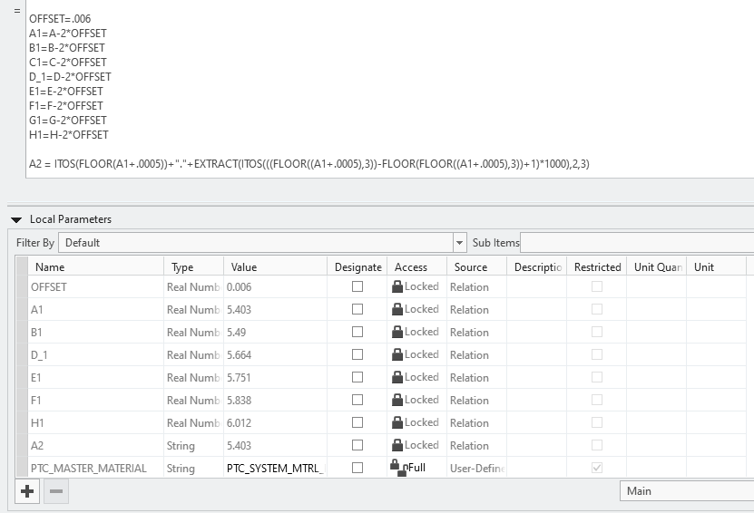

joe_c
(To:BenLoosli)
This is a lifesaver discussion.  But it seems we can only use the string in the drawing. How to use the new string parameter in the Family table? I get an error message when i use A2 (string parameter) in the table
also, how to use it in a drawing table
