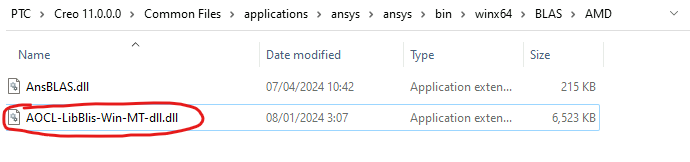

Suggestion: You can try to apply the solution which resolved my problem in Creo 9.0.6.0 and Creo 10.0.2.0.
I copied AOCL-LibBlis-Win-MT-dll.dll file into specific Creo subdirectories:
C:\PTC\Creo9_060\Creo 9.0.6.0\Common Files\applications\ansys\ansys\bin\winx64\BLAS\AMD
C:\PTC\Creo10_020\Creo 10.0.2.0\Common Files\applications\ansys\ansys\bin\winx64\BLAS\AMD
AOCL-LibBlis-Win-MT-dll.dll file is zipped in the attachment. I extracted this file from AOCL installation.
I downloaded AOCL_Windows-setup-4.1.0.204-AMD.exe from https://www.amd.com/en/developer/aocl.html page.
Martin Hanák
Thank you @MartinHanak  👌
I tried it on two simple examples and it's working based on your solution.
CREO 11.0.0.0.- Ansys simulation (based on Azure VM- model: NCasT4_v3-series
Best regards,
David

Note: You forgot to mention that you used AOCL 4.2.0.280 installer.
Martin Hanák
I had the same issue and fixed it with your tips. Thanks.

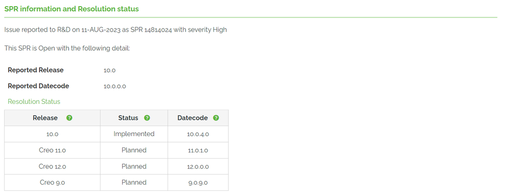

they are still working on it, please wait until the next datecode 11.0.1, or you can use 10.0.4.
2024-05-08_140233.pnghttps://www.ptc.com/en/support/article/CS398825
OP can only keep his fingers crossed...
The main problem is that PTC ignores computers with AMD processor. Their support does not have such computers available!
Martin Hanák
Hello All,
According Article - CS417403 Creo 11.0.1.0 will already have a solution.
