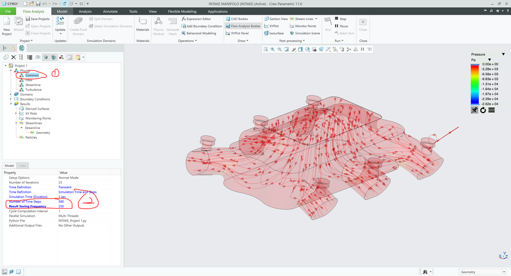

e.g. you setup is 500 steps for 1 sec, you can change saving to 250, you got 2 sres files one is for 0.5 sec, and the other is 1.0 sec. You can load it back and do post processing at that time step.

Hi Dominik,
You need to control the result saving frequency in the common model. After you simulate 1 sec, 0.5 sec result can be loaded back to do any post processing tasks.
