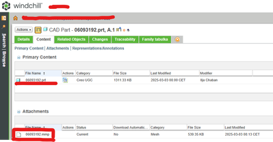

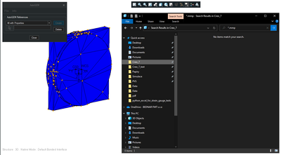

Hello, I've been trying to find those files all around Windchill and my local PC but didn't succeed in that. Where does creo simulate save mesh files?
It took me a while to figure out where it's actually saved. However, it's not in the folder you showed.
I tried following the method you described, but nothing appears in that folder.
I did manage to find the file in Windchill, though. So it seems no separate local files are created on the PC — everything is always stored as part of the cache in Windchill.

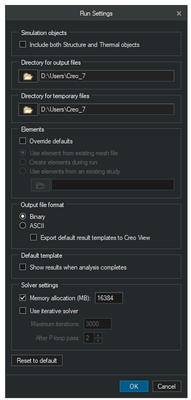

If you have not changed the default settings, it is in a subfolder of your working directory. The name of the sub-folder matches the name of the analysis.
