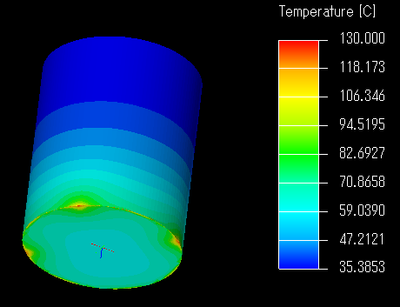

i have an aluminium cylinder De60 Di54 L148 [mm]
with the attached condition (Condition 1 e 2 . jpg)
As a result of the thermal analysis (Thermal_analysis.jpg) i have what show in "Result.jpg" about thermal analysis
I'm not sure that is correct
Can you give me your opinion about it?
Thank you

Your model proportions do not look correct to Diameter 60mm X Length 148mm  with t=3mm.
Sorry Radius external 60 Radius internal 54 Length 148 mm

I've done similar analysis with another solver and got similar result.
