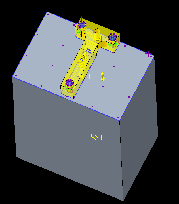

I'm currently working on trying to evaluate the safety of the screws used for a lift bar of a block but seem to not be able to get reasonable values for the stresses inside the bolts. I believe that the model is over constrained but don't know how to fix it. I'm currently using Creo 11 simulate not the live one.
The assembly consists of a large steel block (approx. 4,400 lbs), with a T-shaped lift bar bolted to it. The lift bar is mounted using three screws: two on either end of the top of the T and one at the base. The lifting point is centered on the crossbar of the T (via an eyebolt), and in the simulation this point is fixed. Gravity is applied in the -Y direction using -386.1 in/sec².
The fasteners are 1-inch diameter UNRC coarse-thread screws modeled using Creo Simulate's screw fastener feature. They are threaded directly into the block (no nuts), with preload disabled. The materials are high-carbon alloy steels.
  • Analysis Type: Structural, nonlinear with large deformation enabled
  • Constraints: Fixed at the lifting eye (midpoint of T-bar)
  • Loads: Gravity only
  • Contact Interface: “Contact” selected between bar and block (surface-to-surface)
  • Mesh: Reasonable for the geometry, but refinement hasn’t improved stability

There are folks on here occasionally who have done a lot more simulation than I, but maybe I can be helpful.
(1) First off, if I were analyzing something like this, I would not include the block. The trouble is it's going to mesh the block and it is a rather large object with respect to the thing you really care about, the "T" bracket. Instead, I'd calculate the mass of the block, then distribute that among the fasteners.
(2) For parts in the assembly, I'd have the "T" bracket and the three bolts. For the contact between the bolts and the counterbores, change the type from bonded to contact or whatever the terminology is. You want the two to be able to slide against each other.
(3) Put the force loads onto the bolts. Maybe add cylindrical surfaces around the bolt representing the length of them that interface with the block holes, so you can apply the load to those areas only.
(4) Put a constraint on the eyebolt hole surfaces to fully constrain the analysis.
This is what I'd try. I hope one of the true experts on this stuff chimes in with better advice if they have it. I'm idealizing the loading as a simple vertical load, perhaps true if the eyebolt is located at the center of gravity.

After many hours of trial and error, I discovered something strange: when using gravity load in Creo, if your units are set to lbm (pound-mass) instead of lbf (pound-force), it ends up multiplying gravity, and a 4000 lb block ends up generating over 100,000 lb of force — way more than expected. Realistically, it should be just 4000 lbf. Once I changed the units, all the screw forces became rational again.
I’m not sure if this is a setting issue on my computer or just a quirk of the software, but switching to a different unit system solved it for me.
As for your suggestion to apply a direct force instead of gravity — that wouldn’t quite work in my case. I’m analyzing a lift bar, and the center of mass isn’t directly under the lift bolt, so the force distribution isn’t symmetric. This is actually the simplified version of what I’m trying to simulate. The full setup involves another block and lift system with 12 bolts and 8 contact surfaces, which seems to be overwhelming Creo. I suspect this is also related to some settings or limitations on my machine, which I’m currently trying to sort out.
