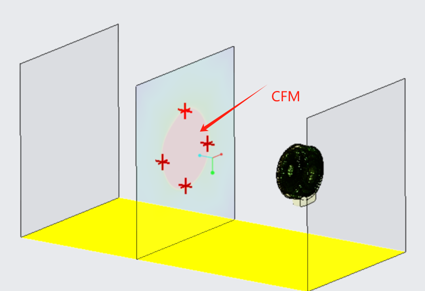

How to calculate the fan air volume. Creo Flow Analysis CFM

Hi
Please create an interface at the outlet of the fan and turn on volumetric flow rate output there. or you can monitor the whole domain flow outlet.

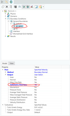

cfdgeek
(To:SZdore)
Create a bc patch and then go to the output session.
SZdore
(To:cfdgeek)
Thank you very much, but how do I view this result parameter.
cfdgeek
(To:SZdore)
Please use xyplot. Please go through the first tutorial case, you will know the details. Thanks
