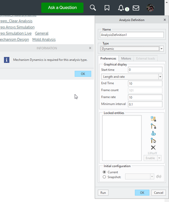

Hello guys, I have a small issue every time I run dynamic analysis in Creo Parametric. If I click the dynamic option, it always says "mechanism dynamics is required for this analysis type meaning". Do you guys know how to fix this or maybe there was a wrong joint or connection with the setting so the I couldn't run dynamic analysis. However, there's no problem with kinematic analysis.

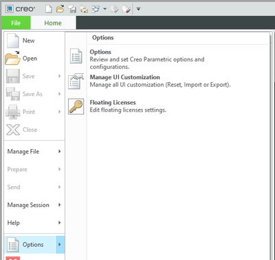

If you have floating options you can check them out as shown below. Mechanism Dynamics can be purchased as a separate floating option, which might be slightly cheaper than buying a Tier3 level license or higher Tier. However there are other capabilities besides this that are added with the Tier3 that for us makes it a better value than floating options. Oh, also your administrator can tie a floating option to your license when you launch creo so you do not need to manually attach the license, however then it can only be released when you exit Creo, rather than check-in or out on demand from this menu.

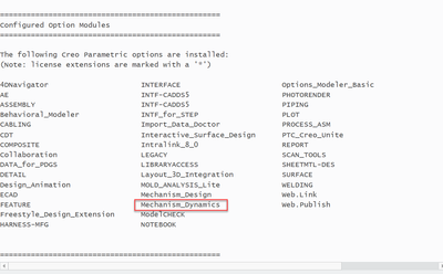

Hello - that looks like a licensing issue.  Check to make sure you have a Mechanism Dynamics option checked out in your session.  Go to File - Help - System Information to show the window like mine down below and make sure you see the Mechanism_Dynamics option as shown.  Which version of Creo are you running?

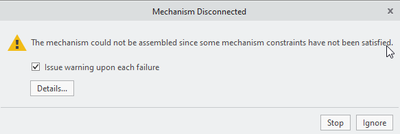

Thank you for the answer, now I understand. I have another problem when running my mechanism analysis it says "The mechanism could not be assembled because some mechanism constraints weren't met". Is it because the joint/assembly isn't properly constraint or what ? Whats the easiest way to know if my parts are connected incorrectly?
