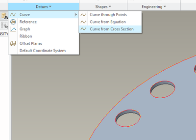

I have an assembly that I've created a section view of, and I'd like to export a file (preferably something like a CSV) that contains a list of the XYZ coordinates of the section.
Ideally, I'm trying to just get the coordinates of the section plane's intersection with the top surface of the model, as if I was tracing a laser measurement tool along a line over the top surface. How would I accomplish this?
I'm using Creo 4.0.

The closest things I can think of is:
1. Curve from section. My suggestion meets none of your requested criteria, export...no, xyz coordinates...no.
It does "trace" the intersection of the section plane and the part.

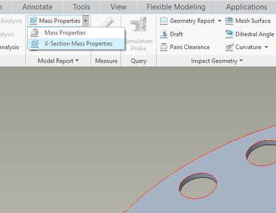

2. X-section mass properties, but again doesn't meet any of your requested criteria but give you the moments of inertia and cg (along with other info) of the x-section.
The thought of "coordinates of a section plane" is difficult in my imagination. Properties of the section plane is easier for me to grasp. Maybe my thoughts are helpful?!???!

Out of the box, without additional extensions such as BMX, I'm thinking you can get your list of XYZ coordinates in this way:
1) Create the curve of interest.  It can be constructed in numerous ways, but sounds like you could simply sketch it by projecting the surface in question onto the sketch plane.  Or you can use the curve from section tool:

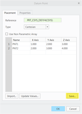

You can use IGES export functionality to streamline this process . It will work in part and assembly mode. Without some use of programming and one of the APIs this is the most efficient method I can think of.
Model Prep:
1) Create the curve of interest in the model
2) Create datum points along the curve from step 1 (pattern the points along the curve at the density needed)
3) Hide all other datum points (other than those on the curve) in the model to exclude them from the export
Import/Export
1) Create an IGES file containing only the point data of interest
      a) In the export dialogue ensure that only "Datum Curves and Points" is active
      b) Select a reference CSYS from your model used to generate the coordinates
      c) Save the IGES file
2) Modify this new IGES file extension by changing it from .igs to .pts file extension
3) Import this new .pts file into a new Creo model as follows
     a) Create a datum point feature using the offset csys option
     b) Select the reference Csys and import the .pts file from step 2, you will then see the table populated with the coordinate values
4) Export this point feature as .pts file format
The .pts file is formatted as shown here:
!       DATUM POINT ARRAY DATA FILE
! Comment lines should begin with an exclamation mark (!).
! You may have as many comment lines as you wish.
! There must be at least one space between values.
! Enter values with respect to datum arrays' coordinate system:
!CARTESIAN coordinates:
!        X                Y                Z
          1.000           2.000           3.000
          2.000           3.000           4.000
