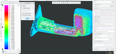

Yes! High Difficulty.
Example pressure map from ACUSOLVE CFD
https://support.ptc.com/help/creo/creo_pma/r10.0/usascii/index.html#page/simulate/simulate/ext_coeff_field.html
https://support.ptc.com/help/creo/creo_pma/r10.0/usascii/index.html#page/simulate/simulate/create_fnf_extern.html#wwID0EZ5VU

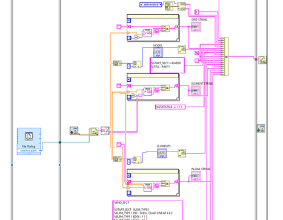

I wrote some code to parse and translate Nastran format CFD pressure to PTC Neutral file format.
Nastran/Optistruct *.FEM output pressure map.

CONVERT TO CREO *.FNF
#PTC_FEM_NEUT 3
#LabView Nastran Converter

External thermal distributions also in similar way.
Easier to do thermal temperature distribution analyzed in Creo thermal then transfer to Creo structure. (like for CTLE stress analysis)

I do not have access / never used Creo Flow, but I am good at search terms to find the hidden gems.
It appears Creo flow can automatically create the FNF file, no coding needed.
Perform a Thermo-Mechanical with Flow Analysis package in Creo Parametric
Creating FNF File For Structural Simulation
Also this in the community.
Thanks a lot! I'll try this in the next days. Best regards
