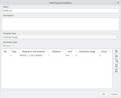

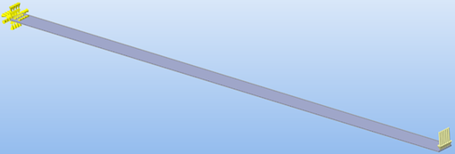

Model: Composite beam. Fully constrained at one side and a normal force of 10 N at the other side. A surface of 20 mm width x 600 mm long is creating the test object. This surface is simplified as a shell with a composite laminate attached to it.
The laminate consists of two 1 mm layer.

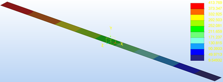

Results according to von Mises shows:
Same stresses as hand calculations are obtained (225 MPa at the middle of the beam). No problems so long.

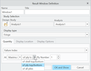

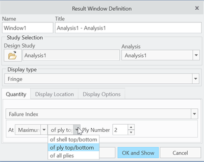

Now to the problem. When you are running a composite analyze you want to analyze the results in failure-index, not von Mises. Failure-index compares tensile and compressive stresses against specified limits in the material data.

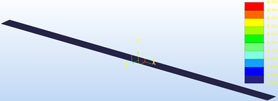

Following is obtained when showing maximum failure-index results at all plies:
Failure index = 0 at the hole beam.

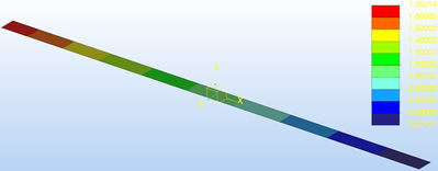

Following is obtained when showing maximum failure-index results at ply 1:
Failure index = 0.9 at the center of the beam. Correct value in compression (225/250 = 0.9).

  • Failure Index – Maximum – of all plies: do not find the highest Failure index.
  • Failure Index – Maximum – of ply top/bottom – Ply Number 2: is not analyzing both sides of the ply, even when it says “of ply top/bottom”. It should give a Failure Index of 0.45 (225/500).

please open Case at support.ptc.com and repeat your question to PTC Support people.
Martin Hanák
please refer to both articles:
https://www.ptc.com/en/support/article/CS345684
and
https://www.ptc.com/en/support/article/CS347331
thank you
