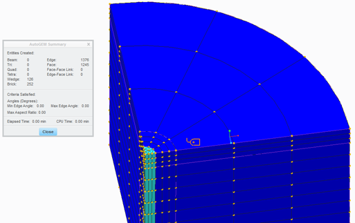

sdensberger
(To:346gnu)
You'll need to slice your volume up, but use the butterfly meshing scheme. The mesh below is all brick elements.
