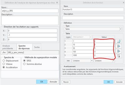

Could someone confirm me that the units used to describe SRS function are the units of the model (i.e. mm, gram, sec) ?
Thank you
you have acceleration toggled so SRS in g (usually) but I suspect you ought to use a consistent set of unit
