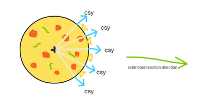

If you sort of know the load direction on the bearing you can constrain a 45 degree portion of the cylinder.
When I get fancy, I divide the 45 degree segment into several regions with their own CSY so I can point the constraint vector in the radial direction but still use cartesian systems so I can do nonlinear analysis. (at least I think that was a restriction at the time) Then I can look at the deflection and stress pattern and adjust my guess direction if needed. I like pizza so I will call it the pizza method 😀
