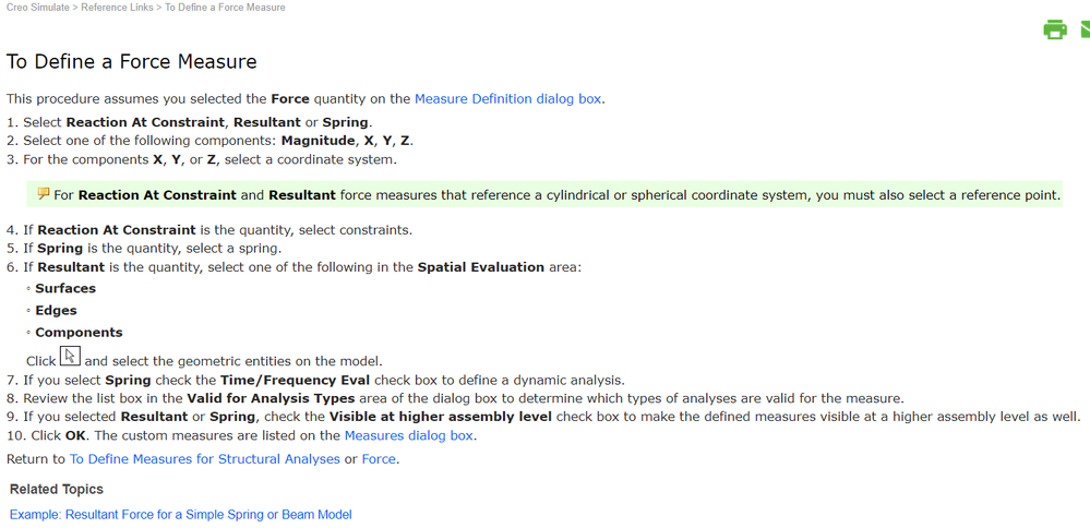

Hello all,
I am working on part in which i want to know the reaction forces acting on the constraints.
For that i have build a example in which you can see the forces acting on it and some constraints
is it possible to calculate the reaction forces in creo?
Thanks in advance for help

Hi, you have to make measures on the target constraint (see pic).
One can also has a graph of displacement, stress and so on over a specified edge or chain.

The documentation in the creo website shows that it is possible to create a measure in cylindrical coordinate
please follow the 3rd point

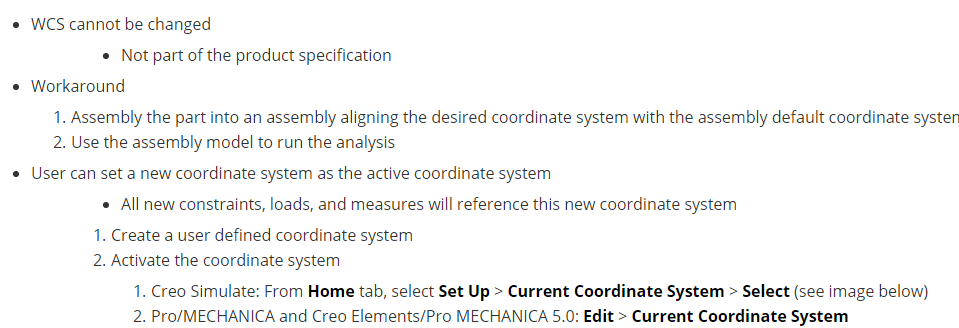

And also it is nor possible to change the world coordinate system.(https://www.ptc.com/en/support/article/CS71234)
What should i do in this case?
I did some trials and you can make a measure like that, on a cil sys BUT the constraint MUST be related on the WCS.
Then, you can make your other cys and obtain the correspondents components.
