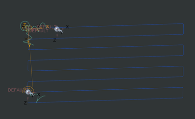

My example creates the path shown. The tools for both methods are shown with their mechanism icons.
See zip files attached.  The .tab, .pts, and .csv are just text files of points.
Path examplePath example

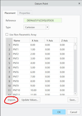

Make a datum point of the type offset from coordinate system, choosing the previously made coordinate system.
Choose the import option per
choose your XYZ file formatted like pathptc.pts.  In that file remember to remove any consecutive points that are identical.  I used an excel formula to add up the absolute value difference  =abs(A1-A0)+abs(B1-B0)+abs(C1-C0) between two rows, then used excel filter (choosing  zero) and deleted rows with differences of zero.    Then choose OK to close the point dialog.

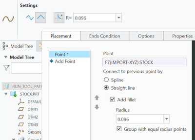

Next make a curve through points, picking the entire set of points with a dialog like this. Choose straight line interpolation and add fillet.
This creates the curve to follow, now you just need a slot interface between this curve and the tool tip of your mill.  Also you will need some way to control the head orientation to the stock.  Once you have this working so you can drag your mill along the path with the drag tool (hand icon) we can get into simulation and measures.  Please upload screenshots to show your work because I cannot open your student version files to look at them.

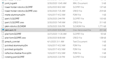

The zip file with all the *.CREO files cannot be opened.  Creo files end like *.prt.1  *.prt.2 *.asm.1 *.asm.2.
I have attached better documentation of the bodies and joints so this can be done in other versions of CREO.  The addition of body Crossbeam_3 with its related pin joint is likely where you are going astray.  Keep in mind what motions the design has to be able to accomplish and if you do not allow the motion, then it will fail to assemble.  Move the parts closer to the correct position with the dragger icon  (blue/red/green arrows on it) before connecting/defining joints.  Build the model slowly, one connection at a time, and use the Drag Components (hand with X) dialog to exercise the model and save/recall snapshots of good configurations/orientations.  Let us know your process and model similar to my table in the attached, what connections work and what step you first get a connection error (cannot assemble).   Use a similar image with numbers and icons too.  This sounds tedious but it will be worthwhile to understand and communicate the model and the effort involved.

edit : how can I make a single curve from the points cause when I want to make a slot connection the curve appears as a segments? I saw you was able to do it in the first attachment file
