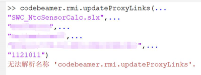

Thanks for your quick response, Based on the guideline, when I use the codeBeamer.rmi.updateProxyLinks, it seems the API is not recognized by MATLAB, and hint to me or do you have a demo to me? Thanks in advance.

Hi @YS_10852132 ,
it is not clear what Codebeamer version you use.
You should use Codebeamer 2.1. or Codebeamer 2.2. for that.
