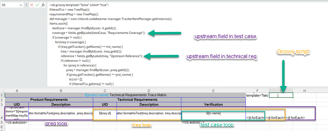

Hello @GLG ,
I have an idea for Excel export, because there you can use Groovy script.
When you start an Excel export on a tracker, the items of the tracker is provided to the Excel as "items".
You can filter, process this list in the Groovy script.
In my example I start from test cases, and build up the traceability upwards.
<cb:groovy template="false" silent="true">
filteredTcs = new TreeMap();
requirementMap = new TreeMap();
def manager = com.intland.codebeamer.manager.TrackerItemManager.getInstance();
items.each({
    testCase = manager.findById(user, it.getId());
    coverage = fields.getByLabel(testCase, "Requirements Coverage");
    if (coverage != null) {
        for(treq in coverage) {
            if (treq.getTracker().getName() == trd_name) {
                treq = manager.findById(user, treq.getId());
                reference = fields.getByLabel(treq, "Upstream Reference");
                if (reference != null) {
                    for (preq in reference) {
                        preq = manager.findById(user, preq.getId());
                        if (preq.getTracker().getName() == prd_name) {
                            tcList = [];
                            if (filteredTcs.get(treq) != null) {
                                tcList = filteredTcs.get(treq);
                            if (!tcList.contains(testCase)) {
                                tcList.add(testCase);
                            filteredTcs.put(treq, tcList);
                            reqList = [];
                            if (requirementMap.get(preq) != null) {
                                reqList = requirementMap.get(preq);
                            if (!reqList.contains(treq)) {
                                reqList.add(treq);
                            requirementMap.put(preq, reqList);
return filteredTcs;
</cb:groovy>
I hope this helps.
