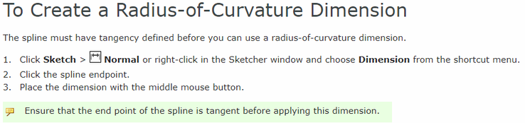

I believe the dimension on the end point of a spline actually controls the radius at the end of the spline.
kdirth
March 27, 2024
From Creo 7 help:
