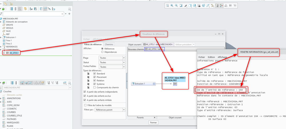

We use Pro/TOOLKIT to explore and analyze PTC CAD files from a Windows executable program.
To do this, we launch Creo via ProEngineerStart() then we load a file into Creo via ProMdlLoad() and finally we browse the different entities present in the file such as for example geometric tolerances via ProMdlGtolVisit().
My question is: Is it possible to access the reference feature ID of a geometric tolerance from a Pro/TOOLKIT function?
I am attaching a screenshot in which you can see the procedure to follow to view this information in Creo.
Thank you in advance for your help.
Sincerely.

extern ProError ProAnnotationelemFeatureGet (ProAnnotationElem       *element,
					     ProFeature                 *feat);
  Purpose:  Gets the feature that owns an annotation element.
  Licensing Requirement:
          TOOLKIT for 3D Drawings
  Input Arguments:
    element       - The annotation element.
  Output Arguments:
    feat          - The feature that owns the element.
  Return Values:
    PRO_TK_NO_ERROR   - The function succeeded.
    PRO_TK_BAD_INPUTS - One or more inputs was invalid.
Maybe that helps. Take care of your Lic Key 🙂

Bonjour.
Merci pour votre réponse qui répond à ma problématique.
Bonne journée.
Cordialement.
