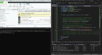

Hello no matter what I'm doing button doesn't appear in menu. What am I doing wrong?
Whole Code

1 REPLY 1
Difficult to say what is wrong.
But menu creation is marked as deprecated in the documentation. This is old style for Proe.
Take a look at the chapter "Workflow to Add Menu Items to the Ribbon User Interface".
First of all try to designate your command "inputCommand" with IpfcUICommand.Designate(). Then check if this command is available in Customize Ribbon
