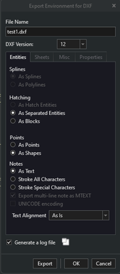

Is this what you are referring to, my DXF export environment dialog looks like this:
I don't have option for chord or angle on any of the menus.
Ok, so your dialog is when you save a dxf from a drawing, in which case you get your dialog, true, and that is what I do too.
I read your post as saving a dxf from a part or assembly, in which case you have the options I mentioned.
Saving from a drawing should be the same geometry as what you see on the screen, so if you see gaps in Creo, they are due to something in Creo.

Saving from a drawing, under the Properties tab, I use DXF Version 2000, (12 is ancient, like 1992).
