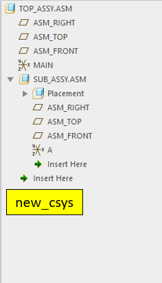

Dear friends,
How to create new csys at "Top_assy.asm" , which same location and orientation of "A" csys, but it should be reference with "Main" csys, not "A" csys.
PS:  "A" csys & "Main" csys, reference handle already with me
Thanks.

I already tried. But the problem is external reference. I need it without external reference.

Creating new csys with UI is very straight forward way. But through toolkit application only i need to perform. It's bit hard to understand. Can you please give the idea on the sequence of API'S above mentioned, that really helps me. Thanks
