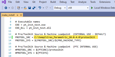

Hello, your problem seems unrelated to Creo API or Visual Studio version conflicts. You need to be able to unzip, locate and write files in the Creo installation directory. It sounds like insufficient file system permissions, drive space or too long/invalid path names (or security software) is the problem here.
I don't use make files so I don't know a great deal about setting one up.
Give this a try:

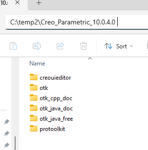

I have my toolkit related files temporarily installed in the location below.
I had to go into the 'make_install' file that is included in the VS project and edit the 'PROTOOL_SRC' variable by adding my toolkit path. FYI: It appears that spaces are not allowed in the path (so I added underscores where needed).
